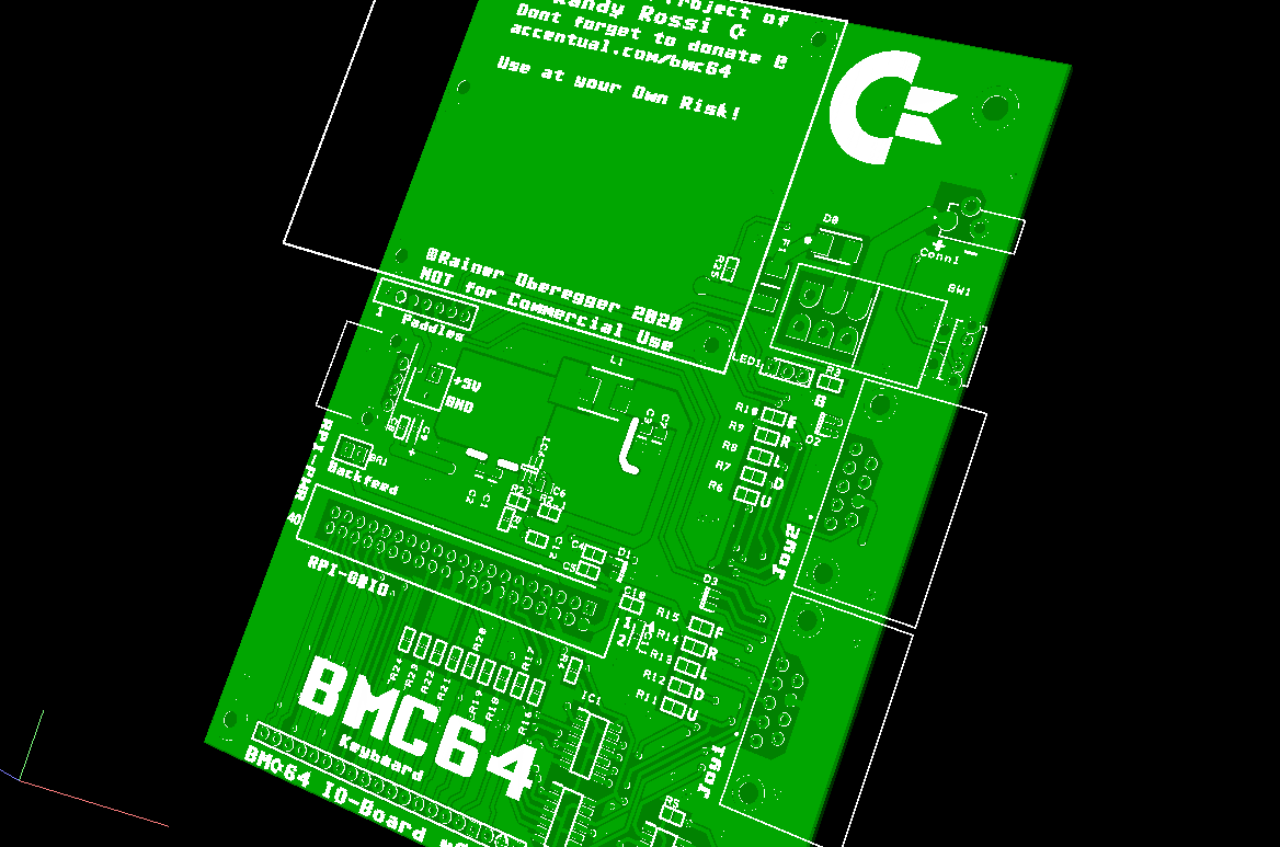

Nueva placa para usar BMC64 con interesantes extras!!
All Joystick Pins are protected against ESD (I hope i did it right) by using protected Port Drivers or ESD Diodes
The Raspberry Pi can easily mounted with 5-8mm Standoffs on the Board, so HDMI and Audio/Composite is directly available from the Cartridge Port
On Power Supply Side i decided to work with a external 12V Power Supply and round connectors.
Power Switch can be a "Original one" T80-R or alternatively a el cheapo slide Switch for lower budgets
Analogue Pins PotX and Poty of the Joystick Ports are routed to a DIL-Header. The Next Step would be a PCB to use a Arduino Pro Micro on a separate Sideboard to provide analogue Ports to VICE via USB Joysticks - i've done no research, nor i testet if that works.
https://www.lemon64.com/forum/viewtopic.php?p=933762

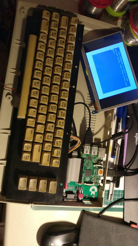

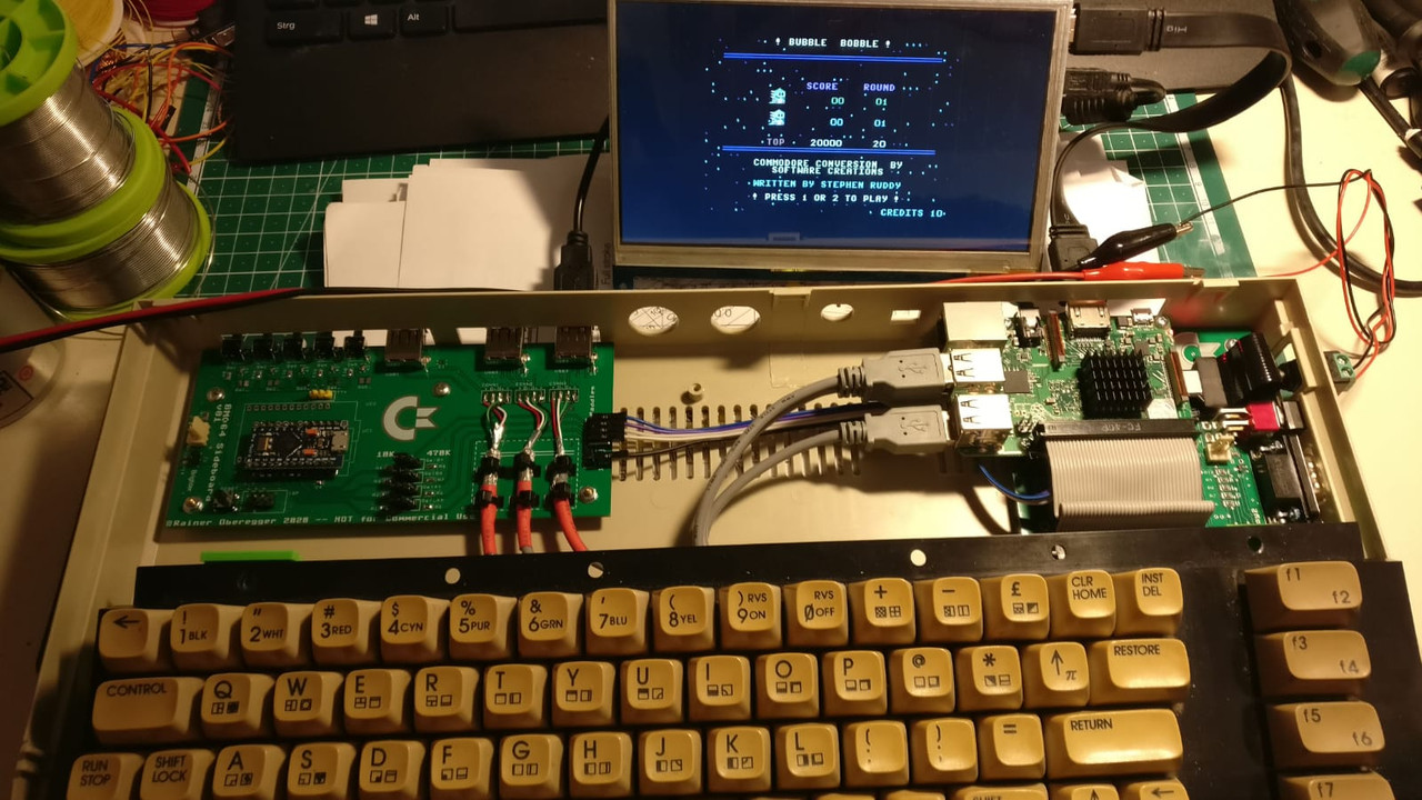

BMC Adapterboard is working, all looks fine.
The included Step Down Controller works really good with verry low Heat - did a Burn In Test with roughly 1.9A for bout 14 Hours.
Sideboard fits as designed minor Changes for the nex Revisions done in CAD:
Typo in Silkscreen for POT-AX
Changed Placement of Resistors (Jumpers for Resistors Paddles) for more convinient Attachment of USB Cable Arduino Pro Micro (small variant)
No Caveeats until now, thats good!
Next Steps:
Firmware for Sideboard:
provide the 5 additional Buttons to BMC64
Analogue Input Handling and providing them as analogue Axis to BMC4
Attention:
Paddles would not work without Changes in BMC64!
Here i need Help @rrossi
Attached a Photo of the actual Setup.
LCD draws additional 600mA via USB, Raspberry is a Pi 3+
If you mind the flat ribbon Cable above the Power-Switch: This is a SD Card extension (SD Card reachable from the Back without opening the C64 Case)
